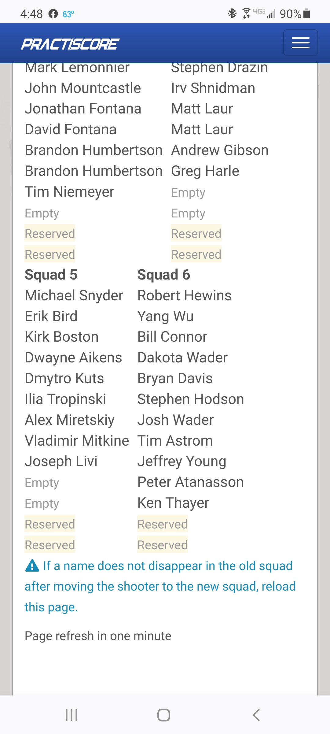

This issue occurs after I use the Managing Squadding page to move shooters around. If I am moving someone on squad 5 to another (reserved) position on squad 5, then I must first delete that shooter from the squad by clicking on the red X. After I have done this, it seems as if the deleted “slot” can not be filled by participant themselves and must be done by the Match Director and only on the Manage Squadding page (Approve View Shooters shows 0/11 on squads 4 and 5 even though there are actually 2/13 available on both. It also does not even show 0/13 on Squad 6). For some reason, only 5 out of 6 of the sqauds show up in the drop down and they seem to only have 11 slots?

This is what a normal shooter sees as available.
This is what an admin sees.
