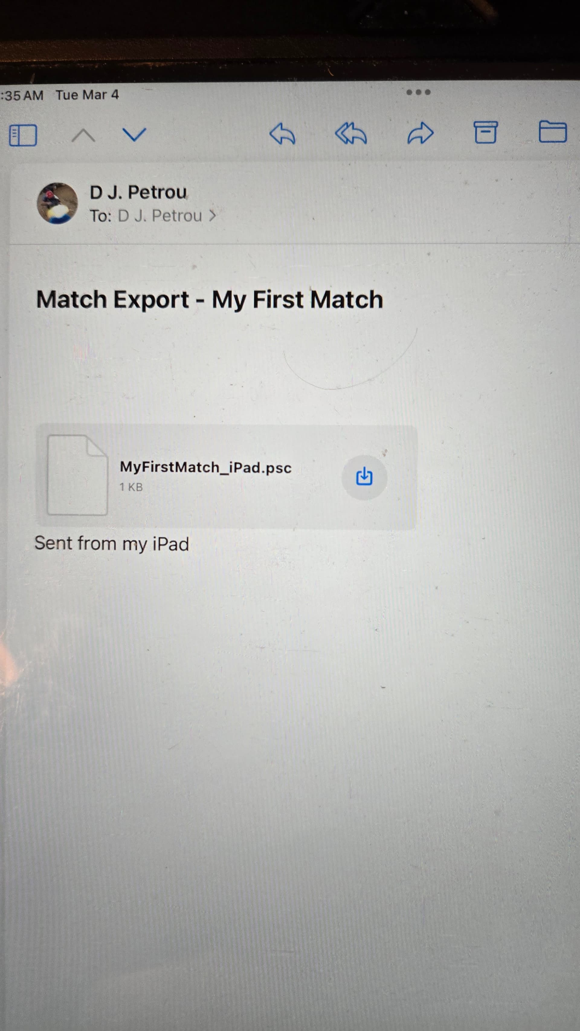

If you must import a match file to 1.0 you would email it in and then open the email. When you download the file you will be able to download it directly to PS in the email. That is only an old iOS function.
