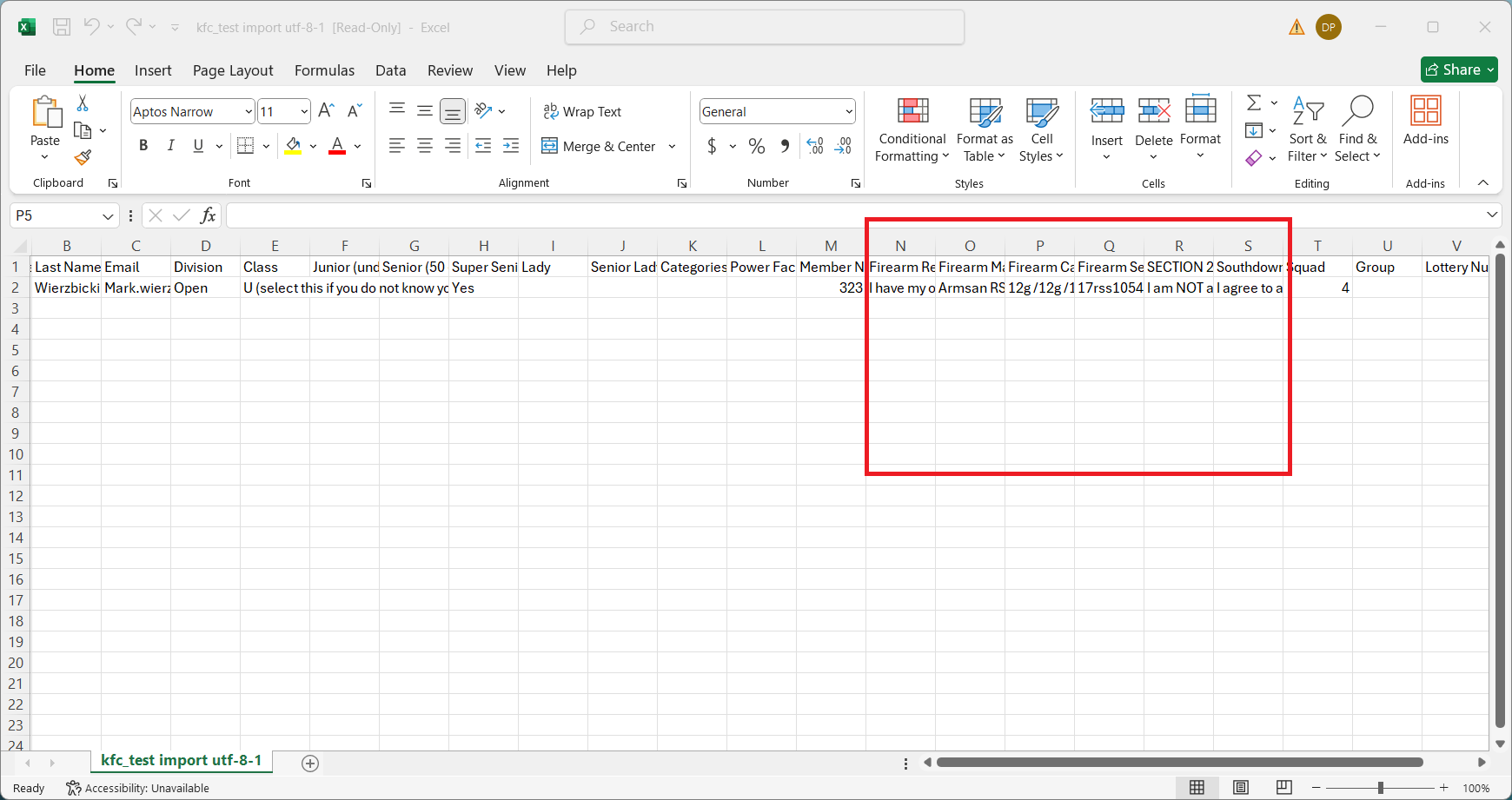

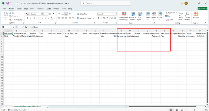

Is this csv that you just emailed the exact csv you are trying to import???
It’s not the same as the exported file. You don’t get to add columns to the csv.
This is the one you downloaded from the test match.
this is what you are trying to import, near as I can understand.
Dear D.J.Petrou,
There were no columns added. Just the detail inside the columns (as per the tutorial). Even trying to import the down loaded file, with just the single shooter that was exported fails. that file is as exported.

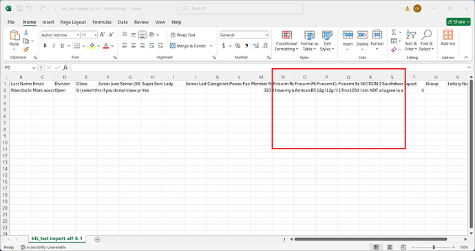

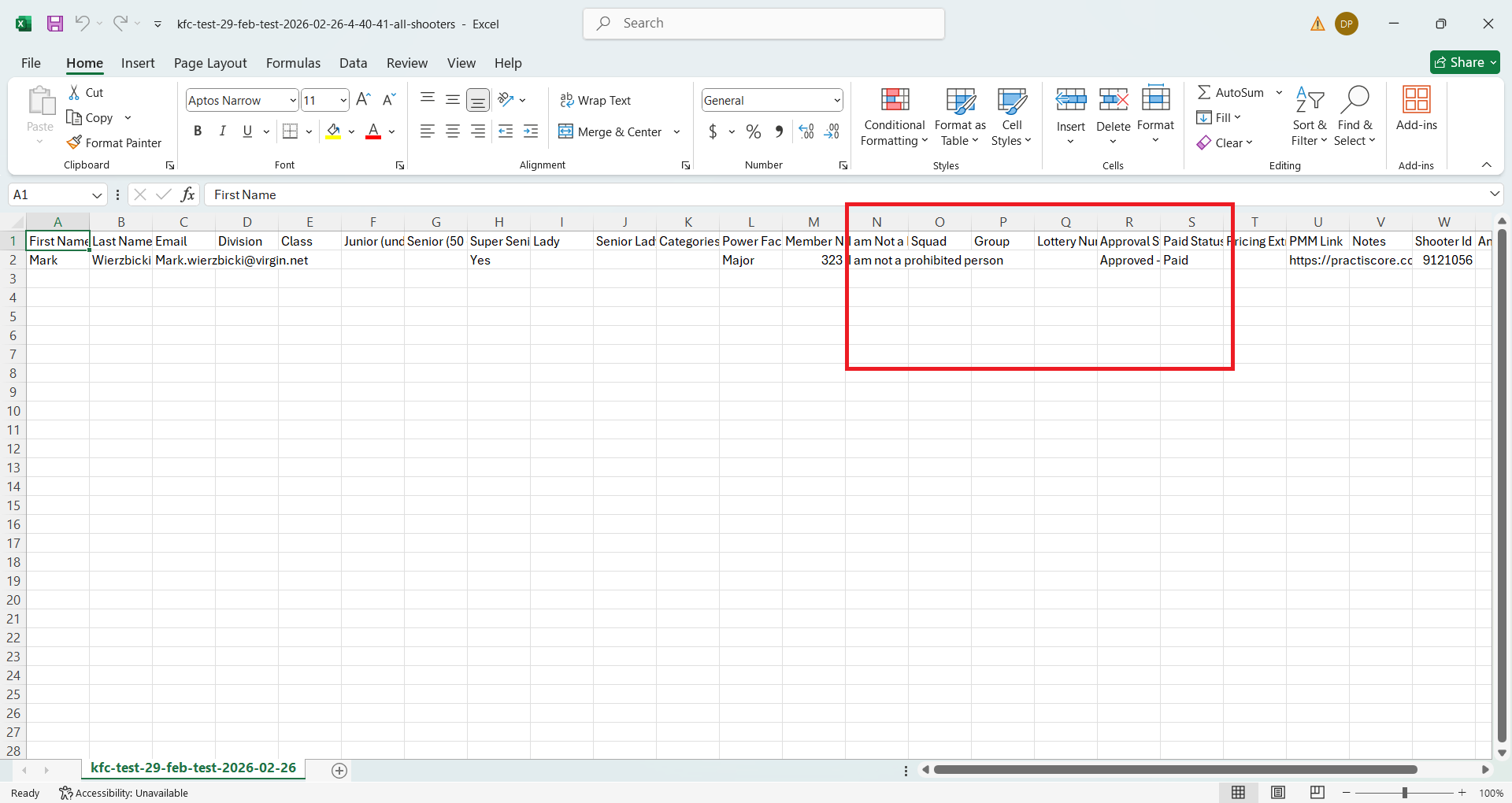

Look at the photos above.
Columns N thru S are totally different.
One other thing, are any of these matches cloned?
These are two different exports, that i have tried to import. both where generated by practiscore, and both fail. The top one shows, a match where I didn’t include the UK required information on the gun usage. the second match does include the information.
These are examples of two different attempts on two different matches.
