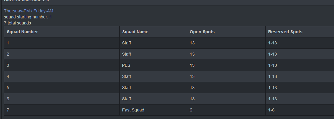

I use squad schedules to separate staff from competitors in big matches. It would seem to be a lot more useful if I could lock or unlock the schedules individually or to maybe even hide some. Am I missing something on how they were intended to be used?

You can lock squads easily and quite a few MDs do using ‘reserved spots’ in the ‘edit schedules/squads’. For our large match, we have the staff squads open when staff pre-register. Then they can squad themselves as they like. Before the match opens for competitors to signup, I just edit the squads so that the staff squads are reserved and the competitor squads are open. That prevents competitors for filling into staff squads where they are not supposed to go. Sometimes we have to reserve a few more spots for special requests or where staff may need to go if they have not pre-registered, and that is all easy to handle by using the reserved spots.
