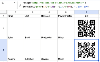

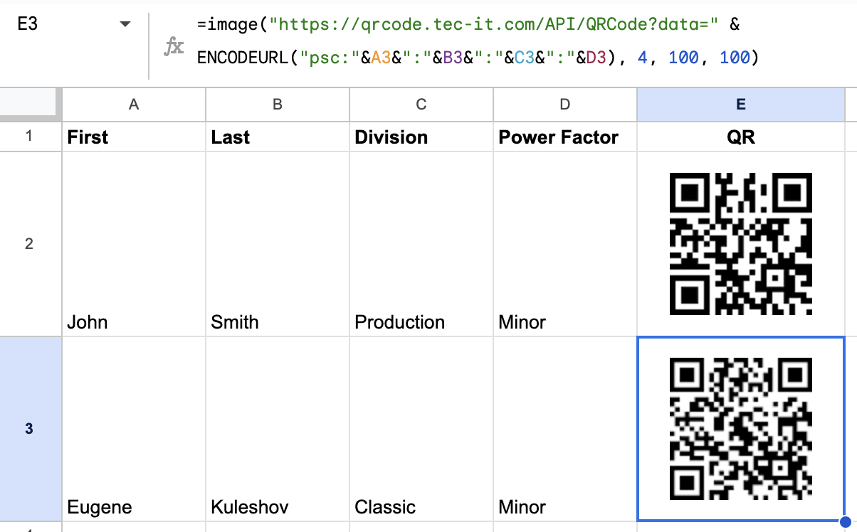

The easiest way to create QR Code up front is to use Google Sheets and use the following formula for QR Code:
=image("https://qrcode.tec-it.com/API/QRCode?data=" & ENCODEURL(<psc:url>))
You will get something like this:
