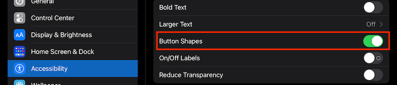

There is an accessibility setting called “Button Shapes”. Turn it off.
https://developer.apple.com/forums/thread/29159
Thank You Russell for you input, unfortunately it doesn’t fix the problems. When I did turn Button Shapes on it did underline the individual character but that is not the problem. The problem is that there is a thin line that runs under the entire row under ‘T#’ columns through the ‘C’ column. Not under the individual characters in the row.
