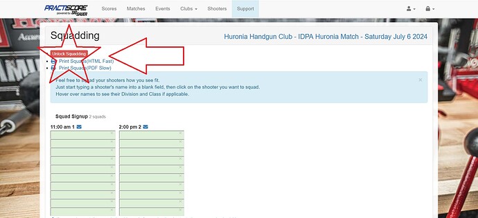

Shooters are able to register for our upcoming match, but there is no link to choose their squad.
Here is match signup link:
Suggestions please.
Thanks, David

This match was cloned, and I locked the squadding the evening before the match.
Just unlocked the squadding, and it seems to have fixed it.
It was driving me crazy.
David
