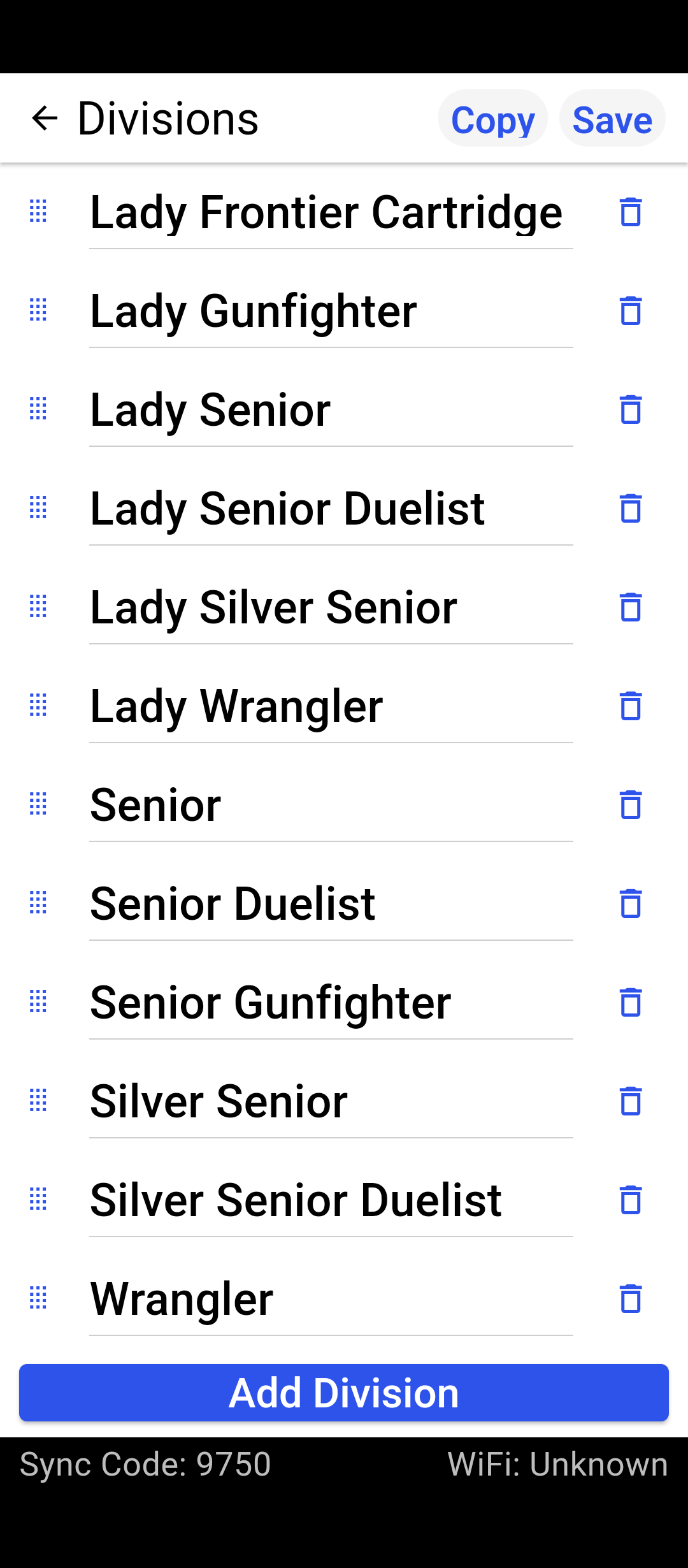

I run cowboy matches, and I want to add a category, but can’t find a place to do so. Please help.

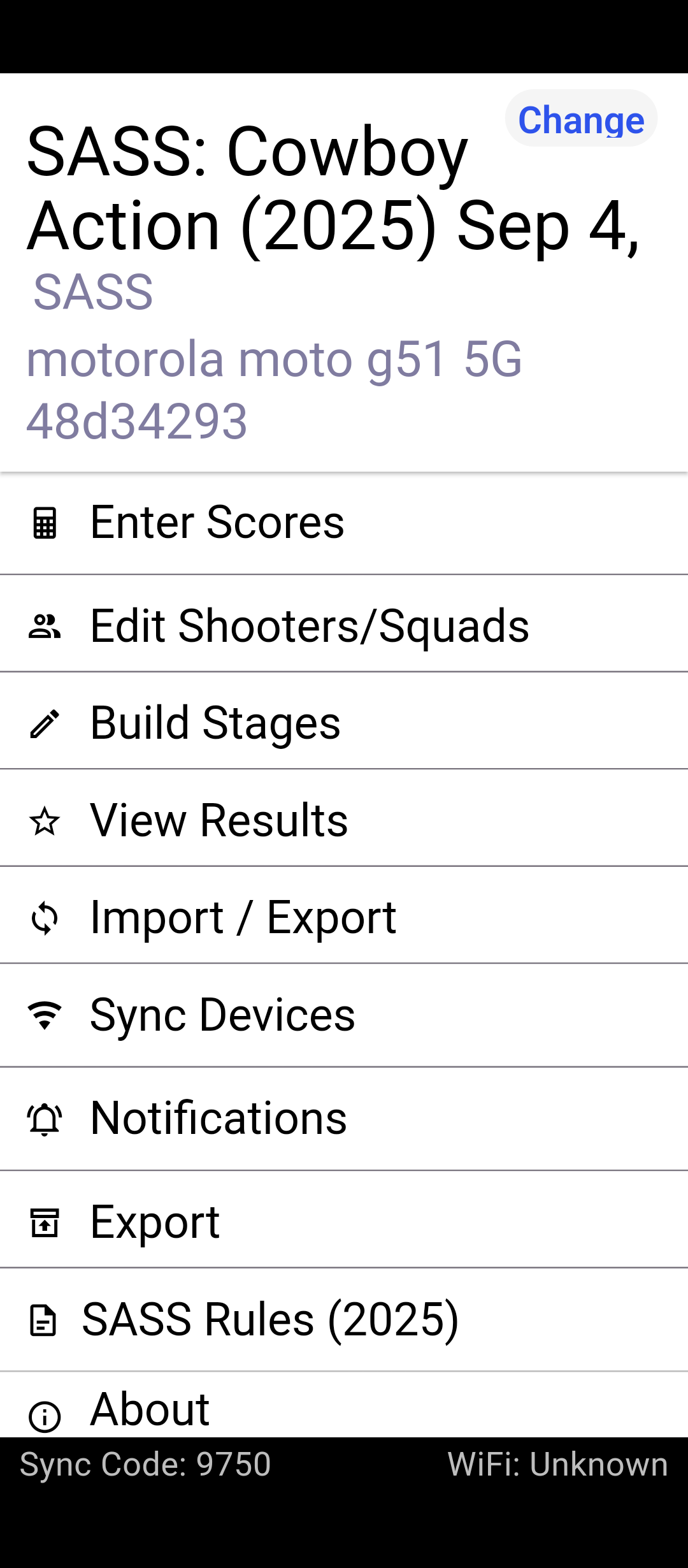

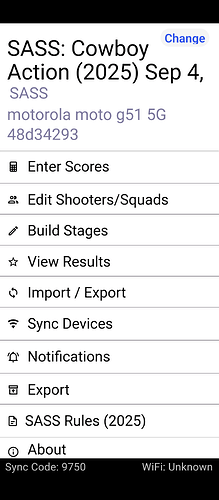

Edit shooters/squads. Top right menu. Divisions
Click on Edit Shooters/Squads

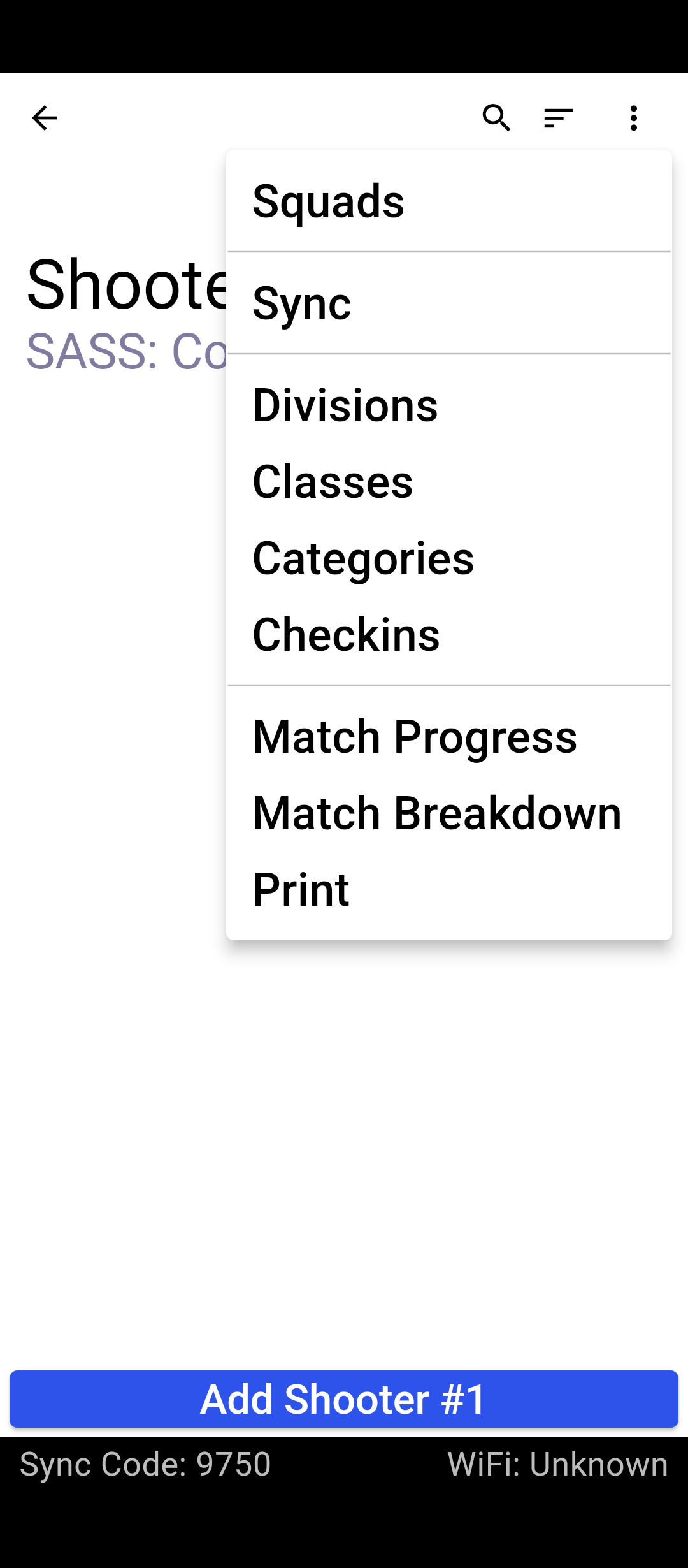

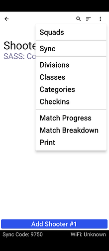

Click the three dots at the top right
Click on Divisions

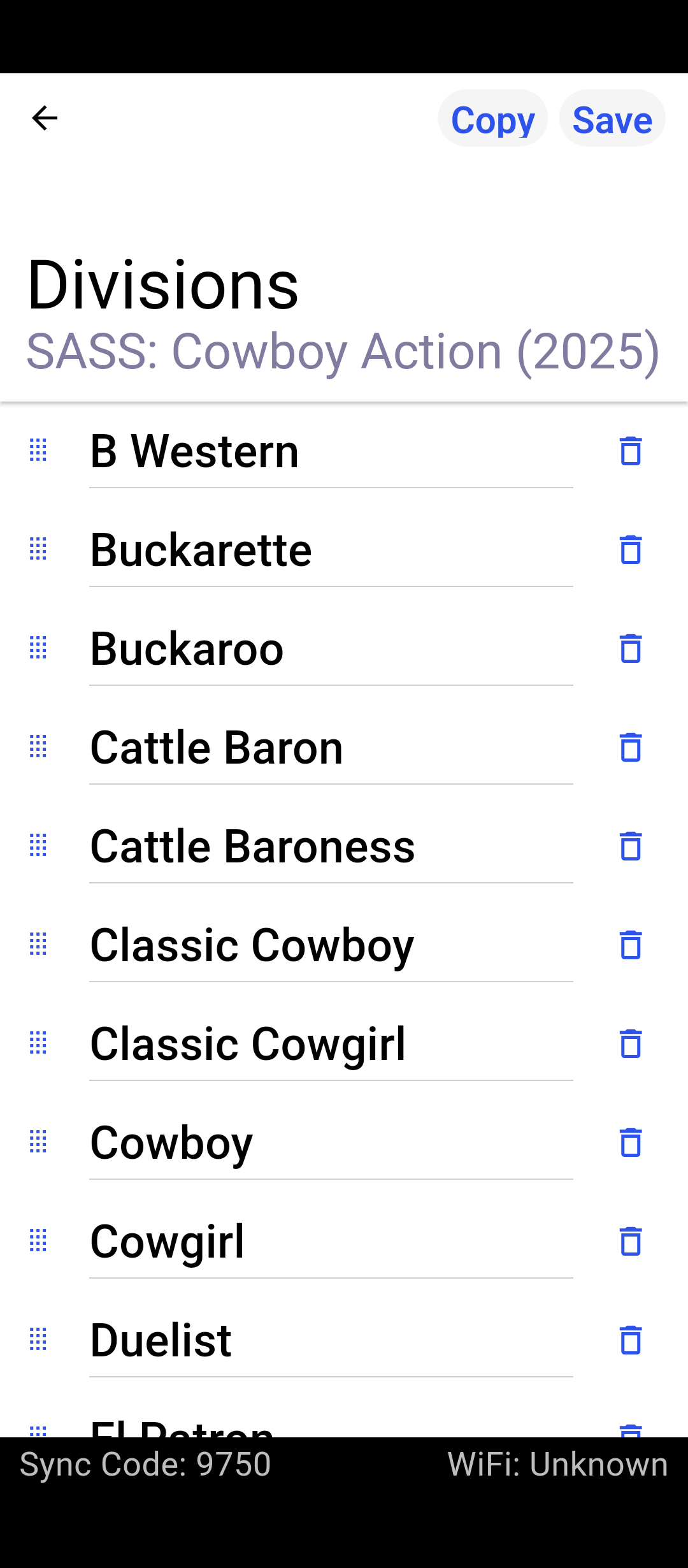

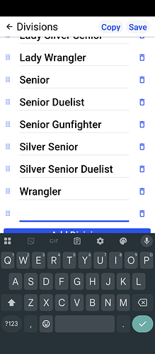

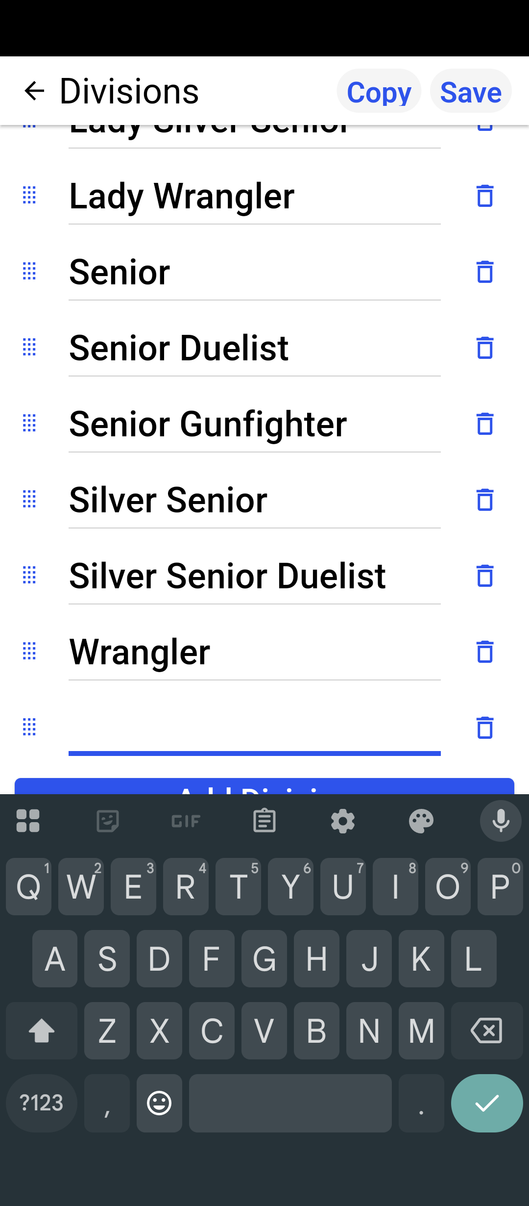

Scroll down to the bottom
Click on Add Division
