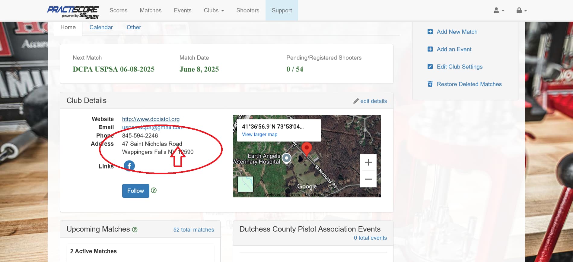

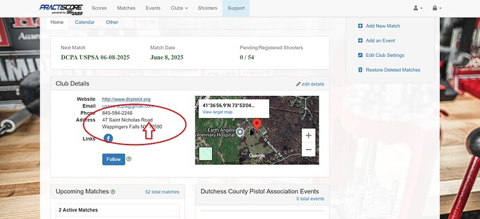

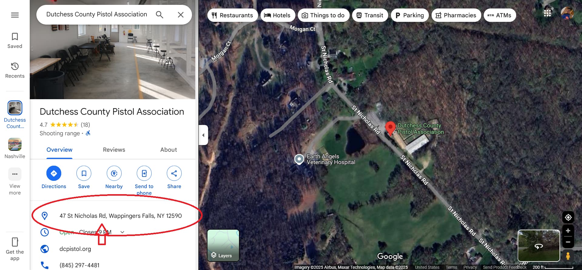

Now The Duchess County Pistol club does not have the correct address for the club location that Google maps uses.
We use Google Geo locator map system. If your address is not Exactly what google uses the system doesn’t function correctly or accurately.
The fix is to go to google maps and search for the club. Choose the club address that google gives you and when the location pops up you should use the Exact (to the capitalization and abbreviations) that google uses for the club and match addresses.

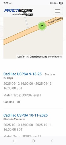

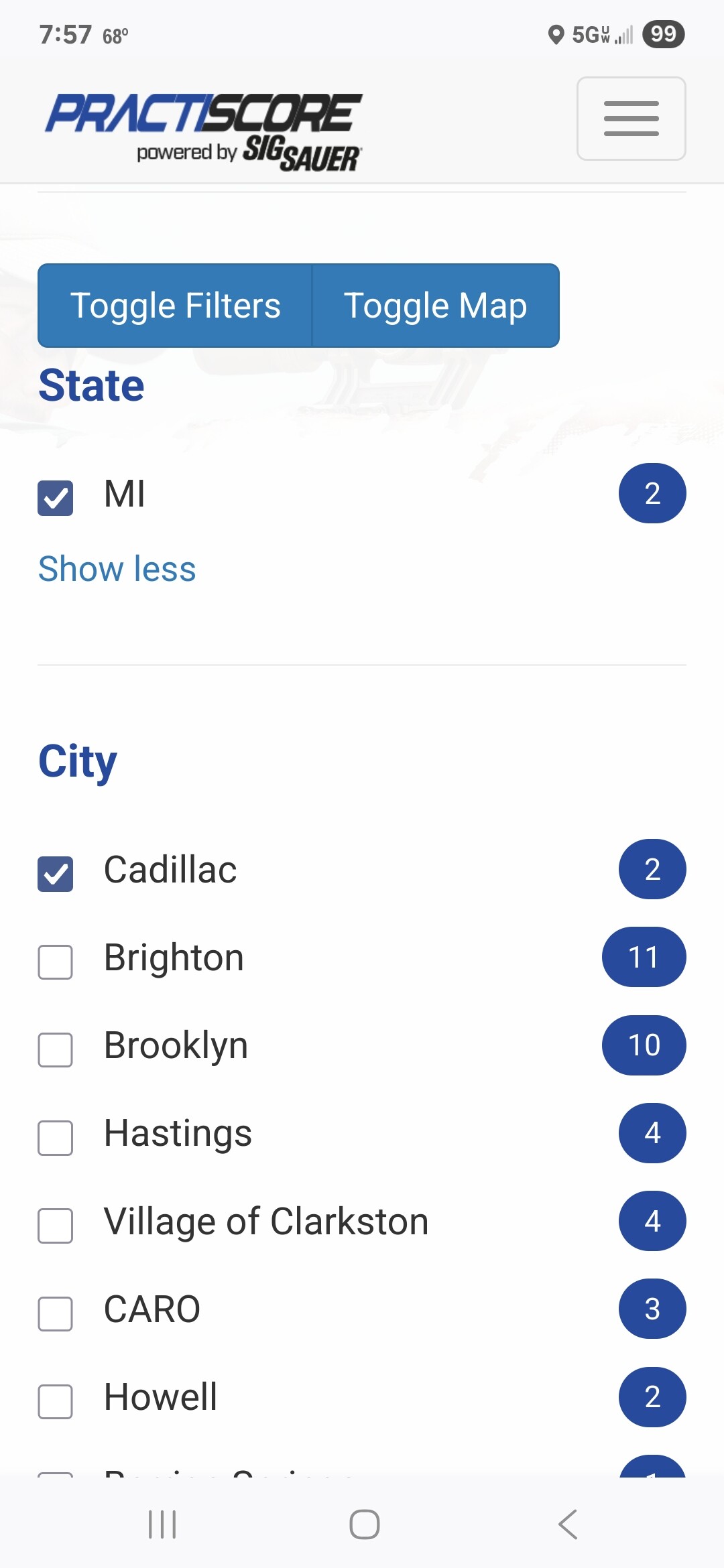

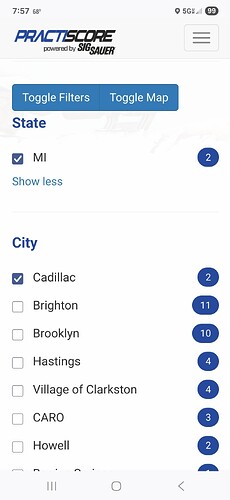

Not sure why you say this is not working here are two screenshots for my phone where I set my location in Michigan not Virginia where I am right now and chose MI and Cadillac as you can see in my choices. And it found these two matches. ![]()
Because MI is not Michigan. No one in Michigan will pass over the filter option for Michigan to click MI further down. Why do the results you clipped show ‘Cadillac - MI’ rather than ‘Cadillac - Michigan’. All other clubs in Michigan, except maybe one, says Club Name - Michigan, not Club Name - MI.
Sorry, I’m probably not making myself clear. My request boils down to “How can I make the match search result for our matches identify the location as Cadillac - Michigan rather than Cadillac - MI?"
Figured it out. You may require that we use the Google address in club details (which is MI), but you must spell out Michigan in the registration page address to get the Michigan match search filter to find it.
