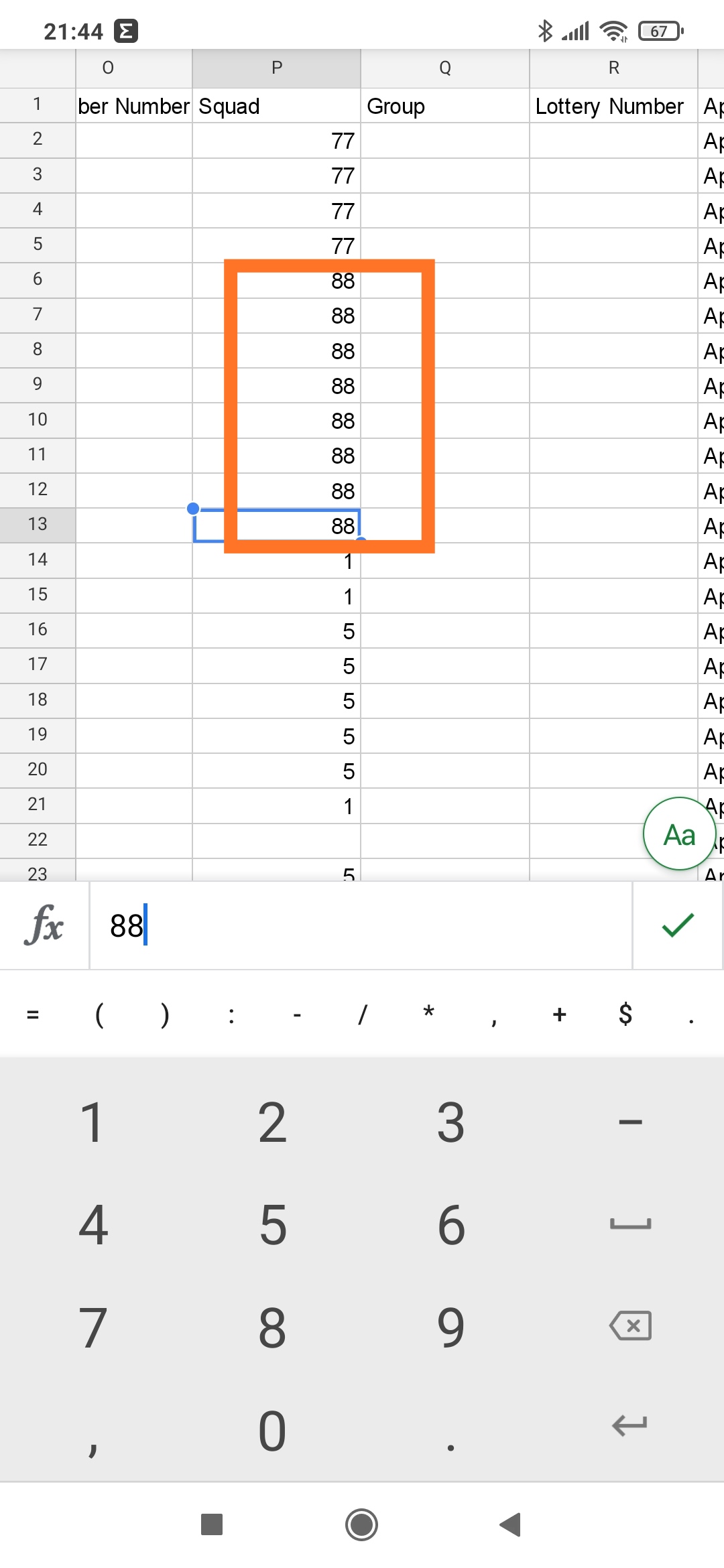

i dont know if we are talking about importing csv to phone / tablet or uploading to website?
because in this case im thinking of csv to phone/tablet
my idea was to edit csv and import to apk
like in this photos
squad 77 is the last squad.
re-squad some shooters to new squad -88
or any other…
and they appear in apk in that squad…
same procedure is to delete whole column, and imput manualy number for each shooter…
