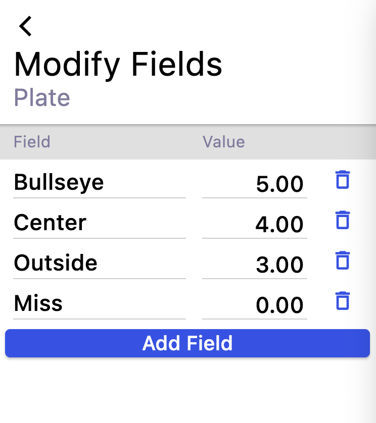

Here’s the second part of my problem: in addition to a standard metallic silhouette match, we also shoot a plate match similar to the original Creedmoor matches.
That is, we have a 4x8’ plates at 100, 200, and 300 yards. Each plate has a bullseye (6", 9", and 12" respectively) and are engaged with .22LR. The plates have 4 scoring areas: the bullseye is worth 5 points, the center 2’x2’ section is worth 3 points, the outside 2’x1’ areas left and right are worth 3 points, and misses score 0.
Can you suggest how to set up scoring for such a match? We generally shoot 15 rounds on each target, so each shot has he potential of 5,4, or 3 points.
thanks in advance for any assistance you can give!
dh
@Doug_Hutter you can slice and dice it in a many ways.
E.g. create a custom “4x8’ Plate” target with scoring zones and corresponding point values as required and name them as you see fit. Then add 15 targets with 1 shot each or use 1 target with 15 hits.
