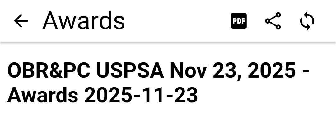

Seeing “share as…”, are you using the old 1.x app? Anyhow that shares the html report that you can open in a web browser then copy into Excel, or load/open directly into Excel or Google Docs.
For your automations you are probably better off with the regular overall match results. Load them into Excel and use that for your calculations.
I’m currently using version 1.2.33+105. The top of my awards tab and the match results tab look like these
