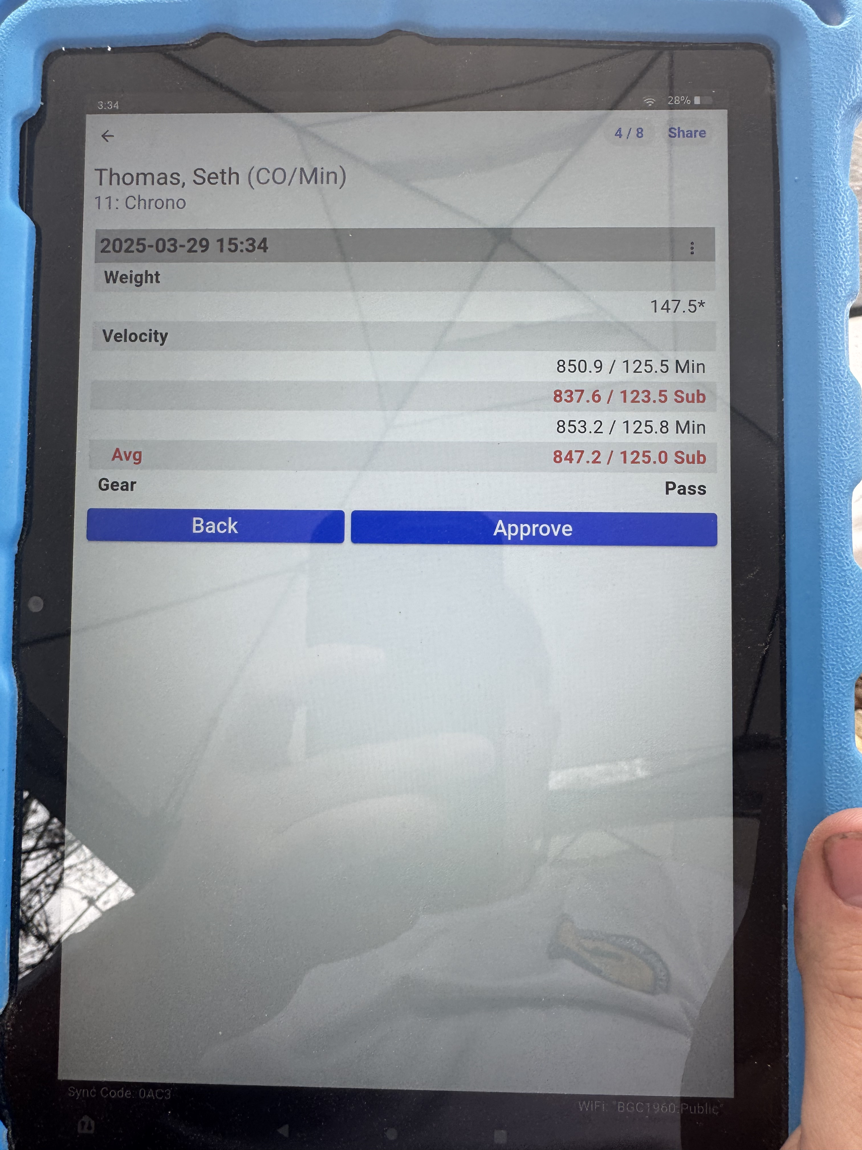

In the recent South Carolina Section match, I had an interesting occurence in PS2.
On the Scoring App, a competitor was listed as having a power factor of 125.0 “Sub” which by the looks of it is incorrect as 125 makes minor.

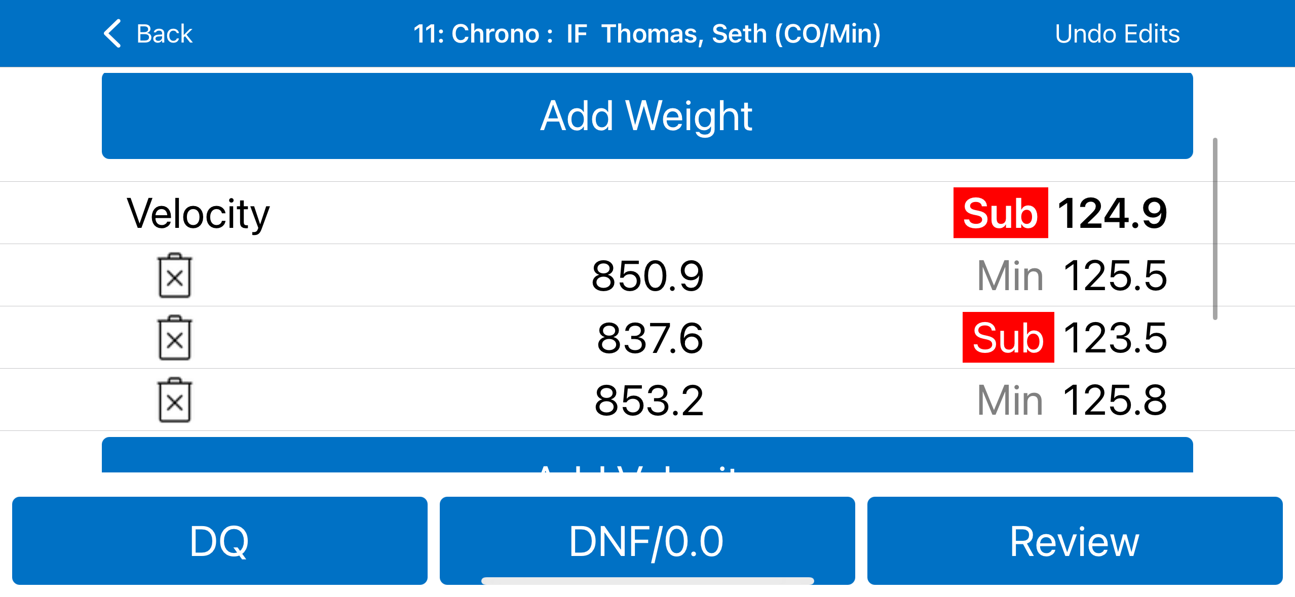

When we pulled the same competitor up in the Competitor app, (and did the math manually) we realized that the competitor actually had a power factor of 124.9 and the scoring app had rounded up which is not correct.
Would love your thoughts…but more so alerting the team of a bug.
@Khory_Katz please email the match export file to support@practiscore.com
